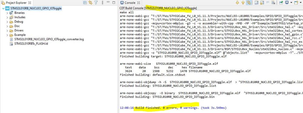

2020-11-01 4:04 PM
It works for me when I open the SW4STM32 .project file. It converts to STM32CubeIDE format and builds just fine:
C:\Users\USERNAME\STM32Cube\Repository\STM32Cube_FW_L0_V1.11.3\Projects\NUCLEO-L010RB\Examples\GPIO\GPIO_IOToggle\SW4STM32\STM32L010RB_NUCLEO_GPIO_IOToggle\.project

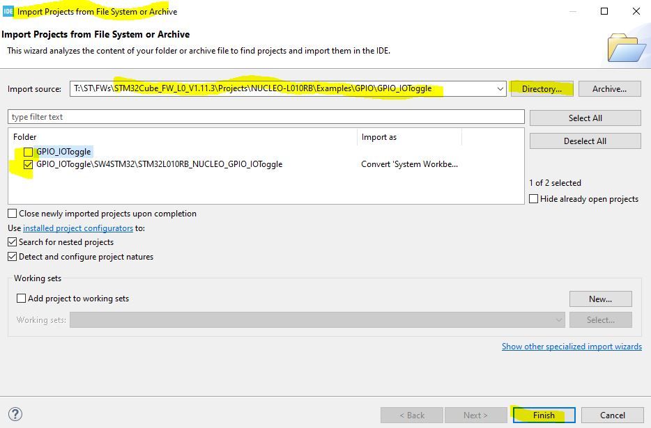

2020-11-02 6:10 AM
2020-11-02 6:33 AM
Having STM32CubeIDE installed, if double clicking on a SW4STM32 .project, STM32CubeIDE is under the hood importing related project as @ABatt.1 is doing thru common Eclipse menus / dialogs but taking care to ommit to check "copy projects into workspace" option.
So @TDK you have no issue because STM32CubeIDE is doing job for you !. By the way if you look a your project's linked material asking for properties you may see your linked file(s) are not local ones (as a "copy projects into workspace" option usage would do).
Expecting to get local material from STM32Cube examples ... STM32CubeIDE example import feaure is your best friend.

2020-11-08 3:10 AM
Hopefuly all STM32Cube examples are STM32CubeIDE compliant.
Let's try File > Open Project From File System ... one click button to get sucess.
