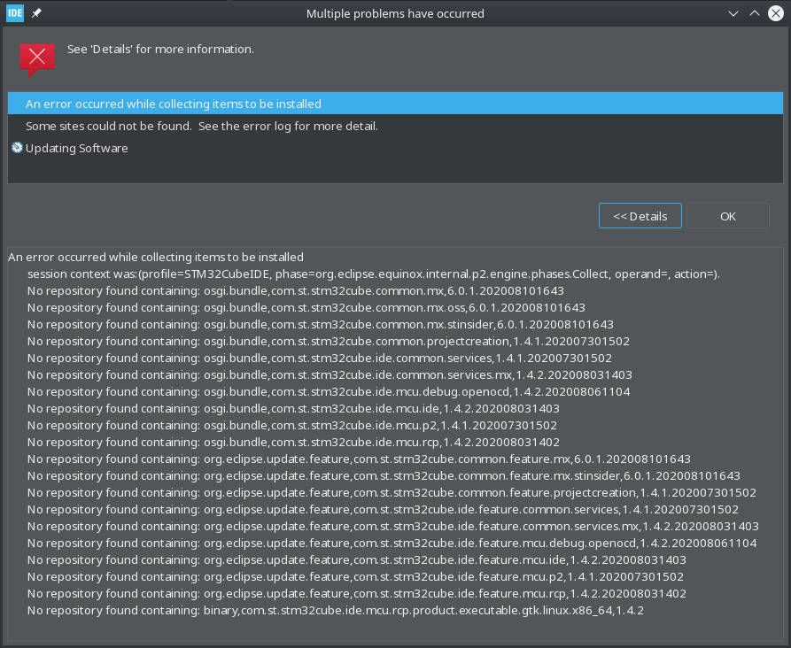

I install the st-stm32cubeide_1.4.0_7511_20200720_0928_amd64.sh, installation OK.
The program indicates that there is version 1.4.2, I start the software update and it gives me the following errors:How can I solve the problem and upgrade to version 1.4.2?

2020-11-02 11:33 PM
Hello JPita,
Thanks for reporting, there was an issue with the repository.
It should be fixed right now.
Could you reload every checked repository sites from Preferences > Install/Update > Available Software Sites and try to update again?
Paste there any error which might occurs during the refresh.

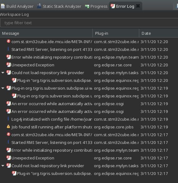

2020-11-03 3:32 AM
Thanks, if I have been successful in the update, I now have version 1.4.2.
I still have the following errors:
Some are from Eclipse but there are also from st, how can it be fixed?
Best regards

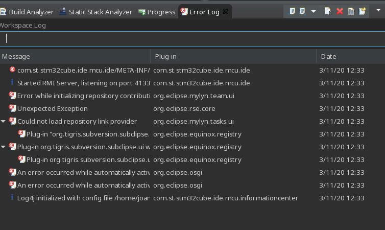

2020-11-03 3:36 AM
In this screenshot you can see the entire URL
2020-11-05 2:48 AM
2020-11-06 9:31 AM
This view displays cumulative logs among all your STM32CubeIDE sessions. This is the representation in GUI of the .log file located in your workspace metadata.
It is useful to understand and debug problems, but like kernel logs, a single error does not necessary means that your entire STM32CubeIDE is corrupted.
For example here the only com.st error log entry is well known and has clearly no impact on any features.
I simply suggest you to close the view and ignore it if everything is fine. If you need a specific answer please share the .log file with your question.
2020-11-08 2:29 AM
Thank you, the stm32cubeide works correctly, I will follow your suggestion.
