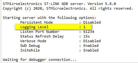

I have found that on one Cube installation is it 31 and on another it mysteriously changed to 1.
https://peter-ftp.co.uk/screenshots/20210421153074214.jpg
The change may have been triggered by me changing between STLINK V2 and STLINK V3 and trying different options to make V3 work reliably (it doesn't but I will make a separate post on that).
I have been all around the program but can't find it. Presumably it is in some script file, which is generated by the form in the attached image.

Thank you! I found the (not same) path on my PC and there is a file called config.txt. The relevant line is wholly commented out:
# -l <Log-Level> : Logging level between 0 & 31
# 0 Disables logging
# >=1 Enables logging of error messages
# >=2 Adds warning messages
# >=4 Adds communication specific messages
# >=8 Adds all information messages
# >=16 Adds all HW specific messages
#-l 31
so it must be using some default value. Weird how it got commented out. I changed it to 4 but it still says 31 (on this PC). So it must be using some other value. In the same directory is a batch file st link gdbserver.bat which contains

This is the output from the PC with log level =1
Starting server with the following options:
Persistent Mode : Disabled
Logging Level : 1
Listen Port Number : 61234
Status Refresh Delay : 15s
Verbose Mode : Disabled
SWD Debug : Enabled
InitWhile : Enabled
and this is the config.txt file section (btw found at
C:\ST\STM32CubeIDE_1.4.0\STM32CubeIDE\plugins\com.st.stm32cube.ide.mcu.externaltools.stlink-gdb-server.win32_1.6.0.202101291314\tools\bin )
