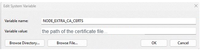

Hi @paolog
In this case, what you need is to configure a proxy or a certificate to be able to access the servers and download packages.
You can also refer to this article for more details on: How to configure the proxy or certificate

Hi @Oussama_TROUDI , thank you for your reply.
I followed the directions on the above link as much as possible, as we don't use Visual Studio Code. We installed the certificate, defined the variable NODE_EXTRA_CA_CERTS to point to the certificate file, and defined proxy in MX2 as "http://Proxy-address:port". But the error is still there.
Should system variable GLOBAL_AGENT_HTTP_PROXY be defined?
Any other option to solve this?
Thank you.
