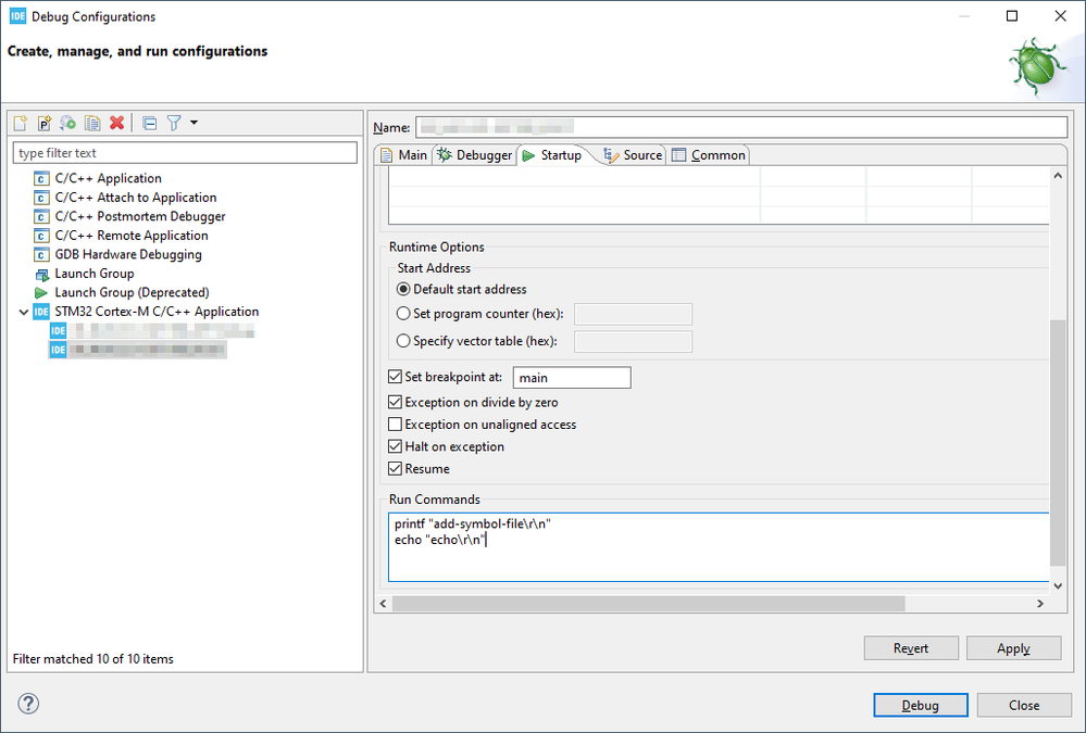

However, I can see gdb is used, and in particular, a gdb script (as indicated by add-symbol-file) is used in Debug Configurations' Run Commands. Since in gdb command scripting there are both echo and printf commands, I thought I should try it in Debug Configurations > Startup tab > Run Commands -- say, the following:
printf "add-symbol-file\r\n"
echo "echo\r\n"
It turns out, that these commands end up in the .launch file of the project:
$ grep -r echo stm32_project_dir/
stm32_project_dir/PROJECTNAME.launch: <stringAttribute key="org.eclipse.cdt.debug.gdbjtag.core.runCommands" value="printf "add-symbol-file\r\n" echo "echo\r\n""/>

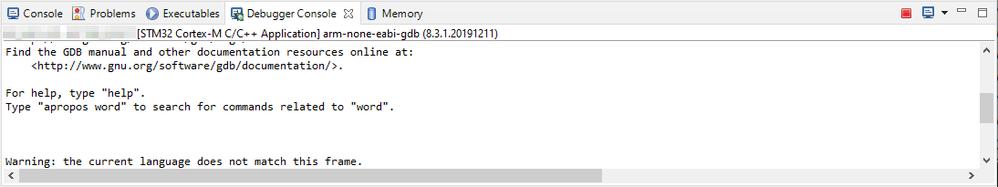

However, when I click Run > Debug, and I finally get a connection to the debugger, I cannot see these printouts anywhere -- at least not in the Debugger Console, where I'd have expected they would appear:
So my main question is:

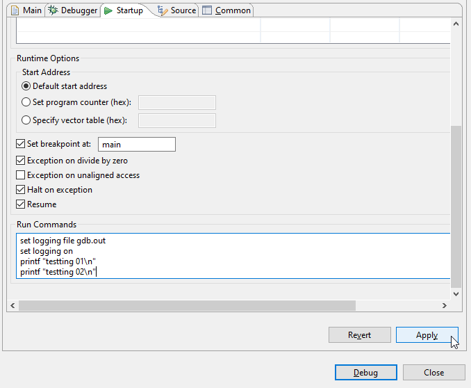

... so I thought, why not try explicitly enabling gdb logging, and see what happens?
So, I entered the below script in Debug Configurations - Run Commands:
... that is:
set logging file gdb.out
set logging on
printf "testting 01\n"
printf "testting 02\n"Upon starting a debug session, there are still no messages in the Debugger Console - however, I do get a `gdb.out` file, with contents like below;

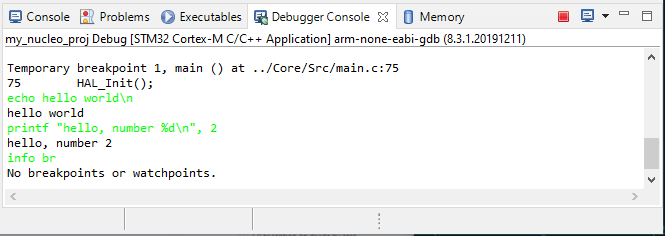

1.It was not quite obvious to me, but you can type in the Debugger Console, once the debugger is halted on a breakpoint; here echo and printf work just fine (however, then you are in the gdb client, so to speak):
2.Actually, even if a plain old gdb command like `info br`, which runs fine when typed in Debug Console, it will print nothing in Debug Console, when saved in "Initialization Commands" or "Run Commands" of Debug Configurations of the debugged project.
