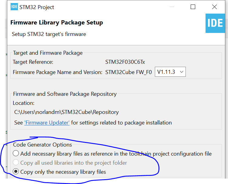

More specifically I am curious as to if you kep the default setting here:
The default is "Copy only the necessary files". This means the all c/h-files are physically copied from your CubeFW repo into your project. No Eclipse/symlinks.
Assuming you kept this default, then the next question is how you tried to duplicate resources. If you drag and drop resources in the CubeIDE project explorer view, then you can move/copy/symlink (symlink in this case is just an Eclipse metadata link) the resource. On Windows default is move. By holding CTRL, you make a copy. By holding ALT you make an Eclipse link.

Hi, Mattias!
I did see that, but it was grayed-out in my build. I will go from scratch again and make it work using both your suggestions. (I made a lot of new projects yesterday!) I did discover that the project-specific settings for C/C++ building are more elaborate than the global WS settings pages (hint!).
