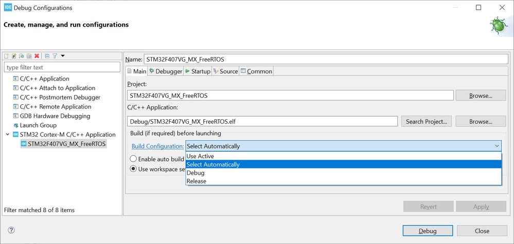

2022-01-31 9:44 AM
@wb0gaz, with respect to you original post:
I think the previously generated debug binary is being sent to the target, rather than the more-recently built release binary (I've gone back and forth a couple of times changing something in the source code to see if the change propagates to the target.)
Is there a different method to push the built project's binary to the target when using release configuration?
Maybe you are already aware, if so, I will still clarify one point to make sure other community members reading this thread does not get confused. :)
As you state there are CubeIDE by default (most often) provides two build configurations, Debug and Release.
Build configurations are separate from launch configurations.
The launch configurations can be used to:
What we have to take care about is that by default ONE launch configuration is explicitly set to point at the build output from ONE build configuration.
So, when building the second build configuration (Release in your case), we should create a second launch configuration pointing at this "optimized" elf-file...
You can change the default behavior and rely on just one launch configuration which then can follow and point to at the elf-file being built by the Active build configuration.
Have a look at this drop-down menu:
Not sure if it brings anything to this discussion or just raises questions..
Anyway, welcome to the C / STM32 world! :)
