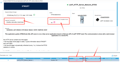

I did this example import again more carefully, and found the following:
It looks like that it's not an STM32CubeIDE version example, is not compatible with CubeIDE, and is not configurable in CubeIDE (actually there is no .ioc file), so is it possible to convert this example from other toolchain/IDE (say MDK-ARM) to CubeIDE?
It would be highly appreciated if someone could share a link of this conversion.

2024-02-05 7:22 PM
See here:
https://wiki.st.com/stm32mpu/wiki/How_to_move_from_SW4STM32_to_STM32CubeIDE
Can also just try "Import ac6 System Workbench for STM32 Project" without the extra steps.
2024-02-06 7:18 AM - edited 2024-02-06 7:21 AM
In CubeIDE, do "Import".... then in the dialog select "Import STM32CubeIDE example".
This option is slightly better than "Import ac6 System Workbench..." as the import tool has more clues. Internally, of course, it will use the SW4STM variant of the example, so all advices on importing from SW4STM and fixes after the import, apply. See also here.
