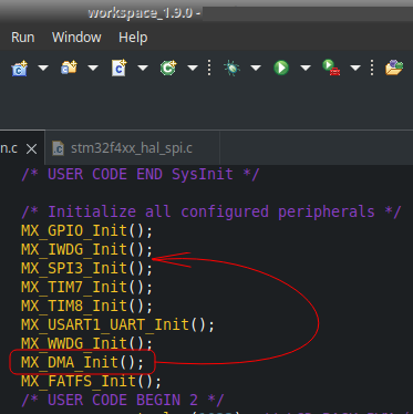

"A regression was detected in the previous STM32CubeMX version 6.3.0 (STM32CubeIDE Version: 1.7.0 ) generating a wrong order of initialization functions.
This issue was fixed in the latest STM32CubeMX version 6.4.0. Thus, newly created project with this version will generate the correct initialization functions order."
"And then called these initialization functions manually in the following user code segment, and now it looks like this"
https://stackoverflow.com/questions/70558087/stm32-spi-ll-dma-transmit
"I couldn't solve it without solving the same problem. But this solution really works. I can't understand why CubeMX is generating wrong code."

hello @rtek1000 ,
Thanks for your feedback,
This is a known issue and it will be fixed soon, for more details please check my answer in this thread.

Hello @rtek1000 ,
This issue is fixed in STM32CubeMX latest release.
V6.6.0 is now available under this Link.
Thanks for your contribution.
