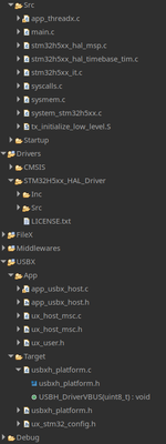

see: this its usb handling:
yes, really doing nothing. perfect tool.

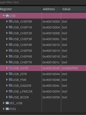

so...is the state machine (usb_connect /..disconect etc) populated there ? or empty frame like i see on H563 ?
and where is activation/setting of usb peripheral (hardware) ?
in all these files with very informative and creative names i cannot find, where the hardware is set to useful state:
the usb registers just stay at this state without any change :

2024-02-06 7:25 AM
@AScha.3 brilliant, thank you! I was missing the call to HAL_PWREx_EnableVddUSB() so the USB registers were just sat there not signalling any device attached.
