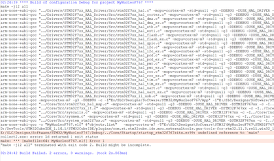

The following is a build after a clean:
I wonder why the compilation of OutputPort.cpp and main.cpp is absent.
Is it possible that something is incorrect in toolset setting?

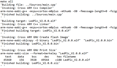

In NXP's IDE, I got this after I have made a change in main.cpp:
and the following are the contents of main.cpp in my NXP project:
