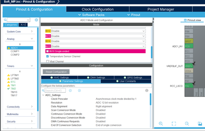

I'm am working with a Nucleo WB55 and I am trying to use the ADC. I assume that the reference voltage used for the conversion is equal to 3.6V because I think that this is the default settings and because when I connect 3.3V to the 12 bits ADC input, I only get about 4040/4095. I saw on other posts that a configuration panel is available for VREF BUFF, but it doesn't exist in my STM32CubeMX even if I can choose VREF BUFF as an output on VREF+ pin.
Here is my pinout view where I can choose VREF+ as VREFBUF_OUT :

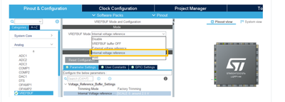

Here is the panel of someone else where VREF BUFF can be configured :

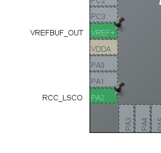

Finally here is mine where I can't configure VREF BUFF :
My question is : the microcontroller i use allows to use VREF BUFF but I can't configure it in STM32CubeMX. Can someone help me on that?

You can find the VREFBUF mode configuration under System Core, SYS, VREFBUF Mode.

Hello @Mahmoud Ben Romdhane,
Thank you a lot for your quick answer. This will help me a lot !
