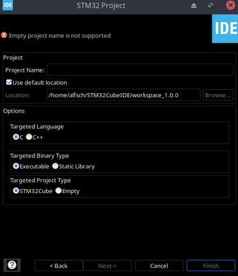

2023-11-20 1:54 AM
2023-11-20 2:06 AM
1. for new -> project -> stm32project -> select cpu -> then:
- give name + sel. c++
2. on existing project right mouse click -> on existing project
- then choose : convert to c++
ok?
2023-11-20 3:18 AM
Please learn to in-line images into posts, doing it as attachments with the same name is particular tedious under Android.. Thanks
