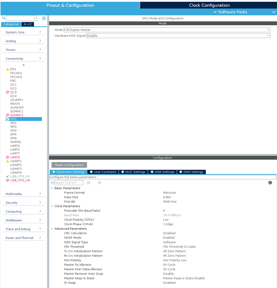

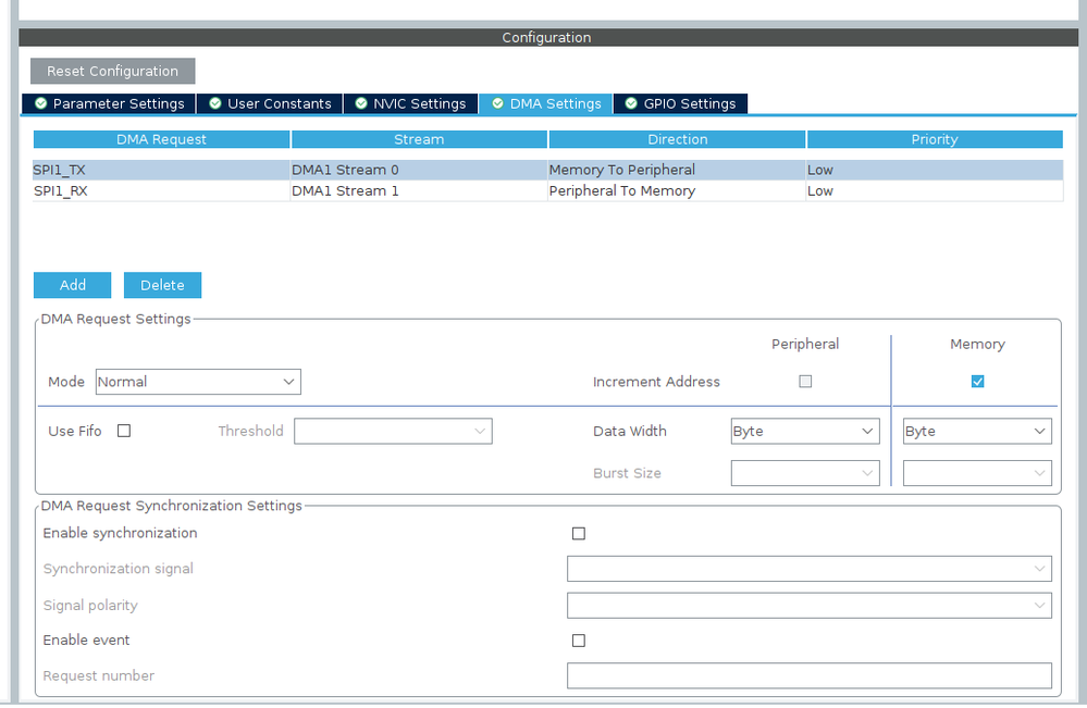

I have used STM32CubeMX to generate the configuration required to use SPI1 with DMA for a nucleo H743ZI2 board:
Then, I generate the code as a Makefile project and modify the main function to have:

}I inspect pin PA5 (as STM32CubeMX indicates is the SPI1 SCK) with my oscilloscope and I see nothing. What is it failing?

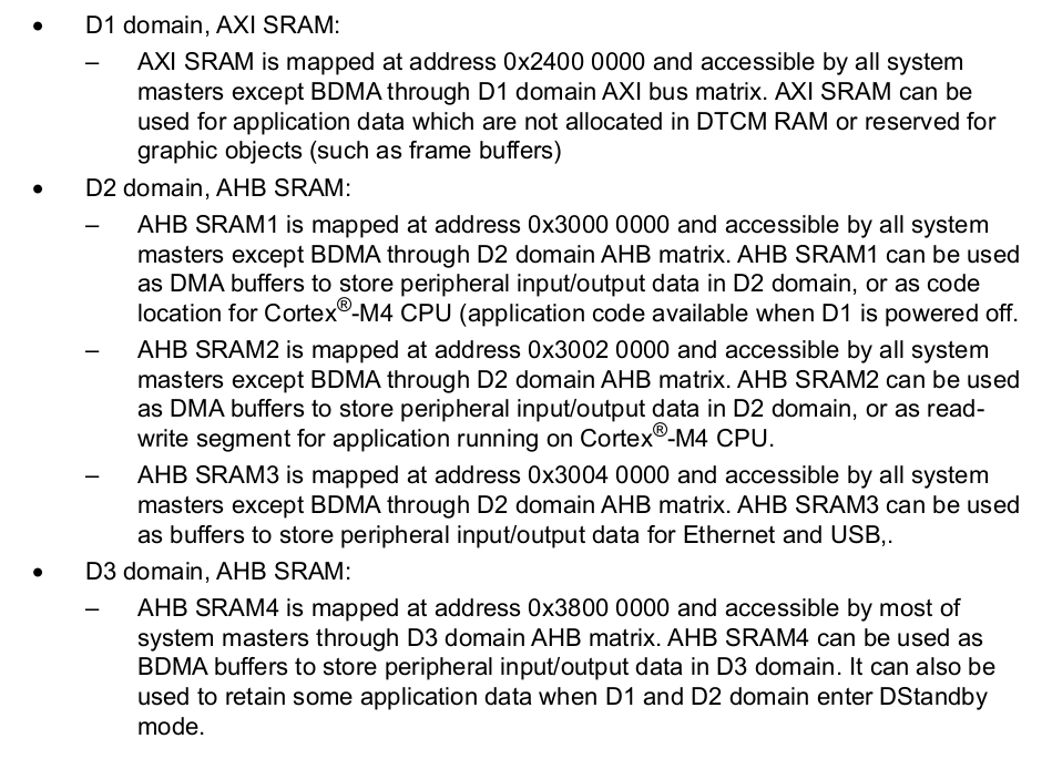

I have read this in the datasheet
So it seems DMA buffers can only be located at specific regions.
2023-02-10 10:39 AM
I have tried to do this quick hack:
static uint32_t* aligned_buff = (uint32_t*)0x24000000;
uint8_t* buff = (uint8_t*)aligned_buff;
HAL_StatusTypeDef rc = HAL_SPI_Transmit_DMA(&hspi1, buff, 8);And it works.
