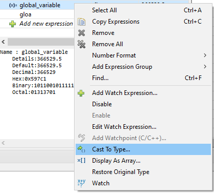

Also, can you check if you have chosen somewhere casting in your code or the option <Cast To Type> inside your view as shown the figure bellow.
