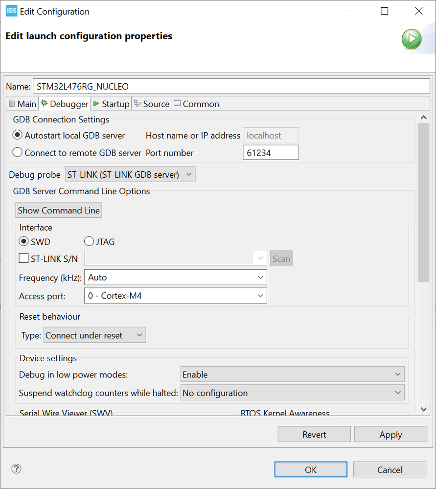

Please make sure to close all instances of STM32CubeIDE, STM32CubeProgrammer.
If it doesn't work, you better update the firmware version check debugger settings. For example:
Otherwise, it would be better to re-install ST-LINK server software.

Thanks, now after a re-installing of the ST-LINK server software and a computer restart, it's working again.
