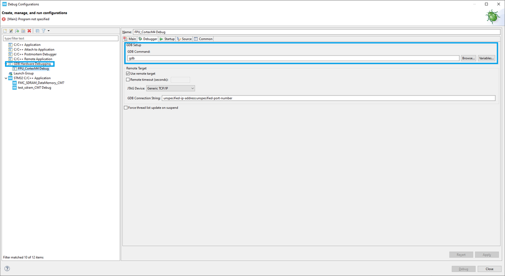

After the installation is complete the PE micro debug configuration is visilbe in debug config in STM32CubeIDE but ST link configuration is not visilbe which was visible earlier.
How do I add the ST link debug configuration now?
Please see attached debug config snapshot

First I want to inform you that we are facing an issue with installing plugins. You can check this post related to the issue.
Our developers are working on the problem and the fix will be available as soon as possible.
This could cause problem when installing the Pe Micro plugin.
I can mention an other solution you can adopt: Go to debug configuration and select "GDB Hardware Debugging"
In this case you should set the debug command line manually.
