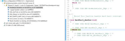

How do you see the hard fault in the debugger? Does your program break into debugger or hang?
Could you post a screenshot?

2025-09-16 11:08 PM
Thank you for checking.
Here are my responses to your three questions:
Please refer to the screenshot above.
The program enters a hang state because it remains in the while(1) loop.

2025-09-17 2:40 PM
The whole call stack is in the internal flash (0x0800000...). No evidence of code running in the external memory.
Please use the hardfault analyzer of the CubeIDE to diagnose.
