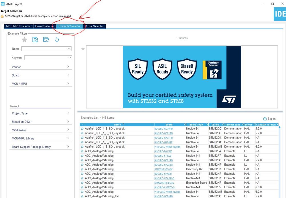

2020-07-30 12:18 AM
Just get a look at target finder extra tab !
