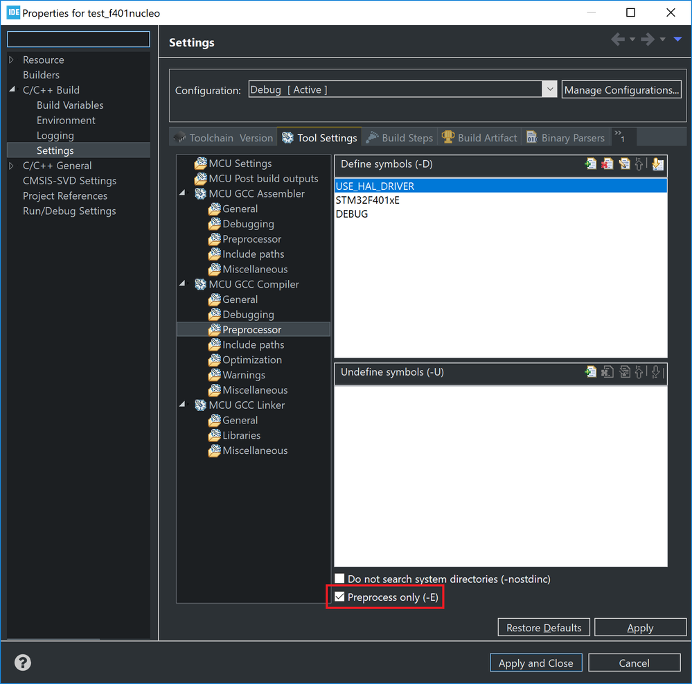

Use the "Preprocess only" checkbox. After that, the converted files will be in the build directory with a "*.o" extension.

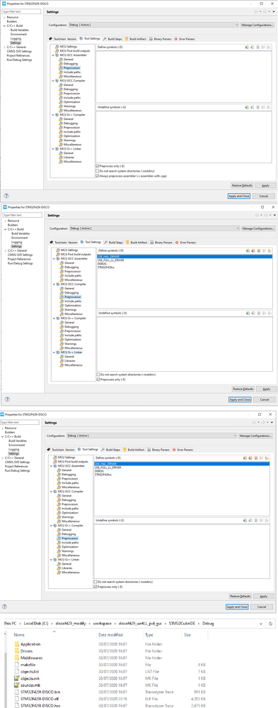

2020-07-30 1:15 AM

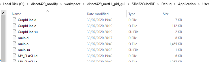

I checked the "Preprocess only" in all the places , and I open my Debug folder and sub directories ,I could not find the *.o extension. Am I doing it correctly?
EDIT: I found the main.o at last. It's in the sub directory users folder
