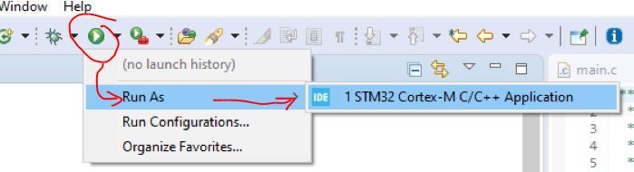

Trying out the new STM32CubeIDE. Mostly, I like it. There are some rough edges and dialogues that do not behave properly (at least on the Mac) but the thing I cannot make work is to add a 'Run' configuration to the toolbar.
I want to just build the code and flash it without having to open the Debug Perspective.
The preferences indicate that he options should be there but hey do not show in the toolbar.
Any ideas?

Since 1.3.0 run mode is supported. Just select your project within project explorer then:

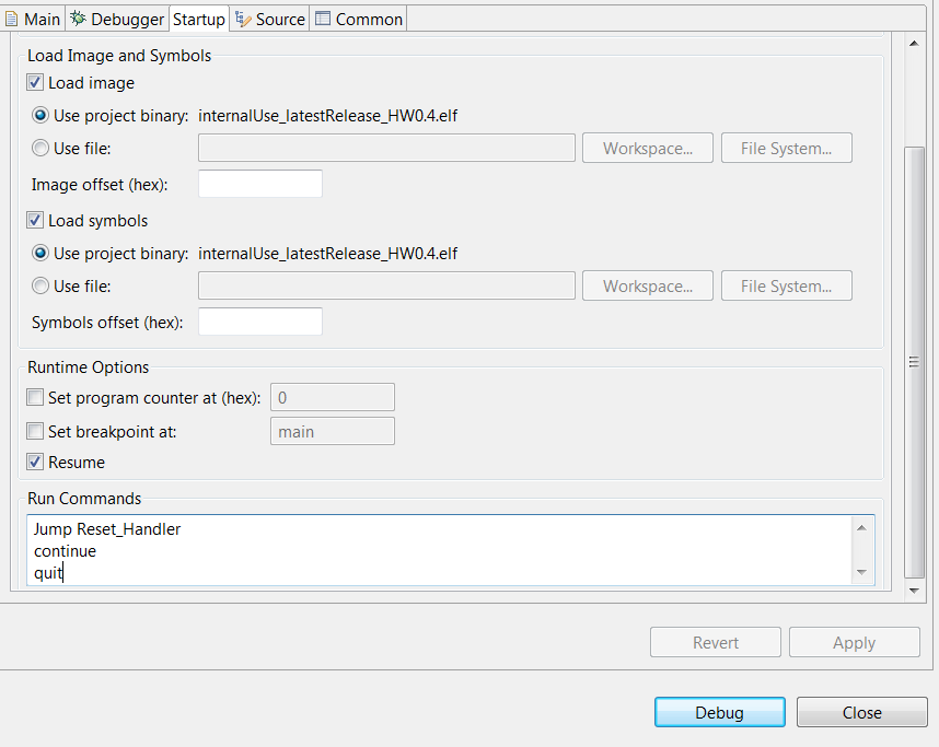

This wasn't implemented in 1.0 as we didn't have time, but it's planned to get implemented at a later point.
For now you can go to the debug configuration to the "Startup" tab and put "quit" in the Run Commands box.
It's the closest thing to a workaround for now.

for me, only adding "quit" did not work out with Segger GDB tool. here is what I needed to add:
2020-07-29 9:10 AM
Ah I see, thanks. That wasn't very clear to me as usually it is called "flash" or "download" but I guess eclipse is designed more for C++ PC applications rather than a dedicated embedded IDE.
