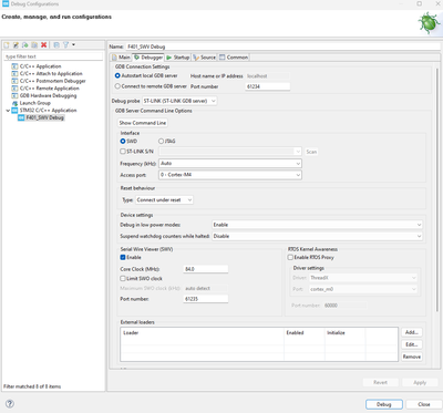

2024-12-12 5:48 PM
After a lot of struggling, I figured it out that you need to hit the down arrow of debug button (bug), debug configuration, debugger and ENABLE SWV checkbox!!!!! It solved the issue for me!
