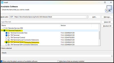

Aha, you probably want the serial terminal. It has been reorganized during Eclipse development.
Now this thing belongs to the "Terminal features". If it is not installed you can add it via Help-> Install new software.

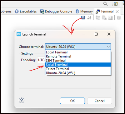

After it is installed: Select the Terminal view (Window->Show View-> Terminal)
And click on the toolbar icon. This will present you selection of all terminal types, including the serial.
2024-12-13 3:38 AM
Thank you!
It works now.
