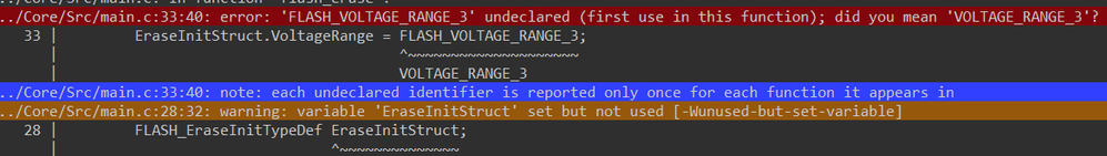

hi. i want to write a variable into stm32h7b0vbt6 flash memory and all of the hal source and header files are added to project. so i have used FLASH_EraseInitTypeDef to erase flash first.
but when i call that, the program not build and shows this error and warning:
error: FLASH_VOLTAGE_RANGE_3' undeclared
warning: variable 'EraseInitStruct' set but not used
how to fix it?

The H7Ax and H7Bx don't have a PSIZE field in FLASH_CR (FLASH_CR_PSIZE undefined)
STM32Cube_FW_H7_V1.12.1\Drivers\CMSIS\Device\ST\STM32H7xx\Include\stm32h7b0xx.h
Present in the H74x, H75x, H72x, H73x forks

FLASH_VOLTAGE_RANGE_3 is defined in the HAL library headers. In particular, here:
Ensure the flash module is being included in the hal_conf*.h file.
Ensure libraries are updated.
If this is code generated directly from an IOC file, include the IOC file here.

Much of the library source / include have #if defined (FLASH_CR_PSIZE)

Hello dear @Tesla DeLorean. thanks, that's right. H7B doesn't have a PSIZE field in FLASH_CR.
