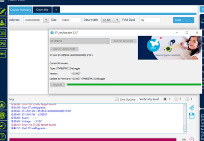

Use the STLink GUI or STM32CubeProgrammer software and see if they can connect to the board. I'm not very familiar with the blue pill boards other than they are pretty bare bones. A wild guess, but maybe, somehow, when programming from CubeIDE it set RDP mode to 1, which prevents debugging. Anyway, try the stand-alone programmer software and see what it shows. If RDP *IS* set to 1, you can then reset it to zero which will also erase the entire FLASH contents.
2020-02-07 4:10 PM
I have installed STM32CubeProgrammer and I can't connect the Bluepill to the stlink2, but I successfully upgraded the firmware

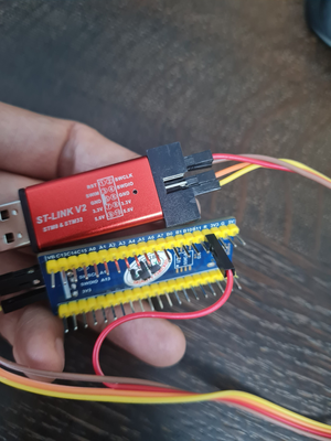

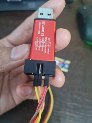

I just did the same mistake as OP, resulting in bricking 4x stm32f103c8t6 / blue pills before i noticed. I just wanted to document and share my solution in case it ever happens again.
Hardware:
Software:
Problem:
Error codes:
Reason: No device found on target.
Solution:
I hope this helps!
2024-06-17 5:53 AM
thank you very much for your solution, I am a fresher with Microcontroller programing, I have same trouble my board was blocked, I have try to solve it as your advice but it still do not connected although it can update drivers,
could you please share some picture for me do the right way.
