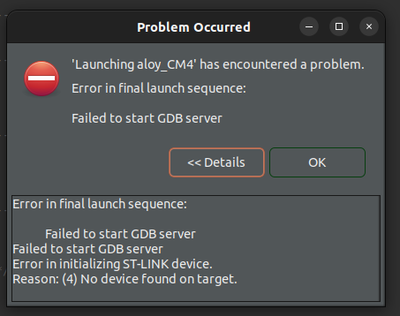

So I am trying out OpenAMP example from STM32CubeIDE. I can compile the example but cannot flash the same.
I have the following error

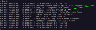

The ST-Link device is present as shown below

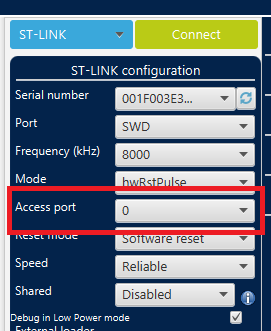

To connect to CM7, you need to set the access port to 0:

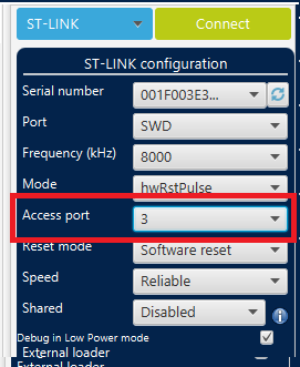

To connect to CM4, you need to set the access port to 3:

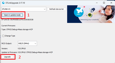

If you succeed to connect with CubeProgrammer, try to update the ST-LINK firmware with CubeProgrammer:
Then,

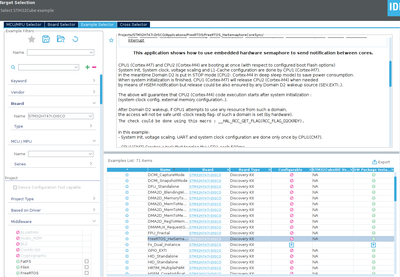

Hi

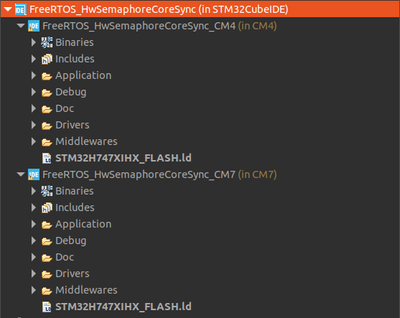

For example I am choosing another example
I can build both the projects generated here
But i am not able to program them into the board

@jo512 wrote:The ST-Link device is present as shown below
So the problem is the connection between the ST-Link and the Target.
