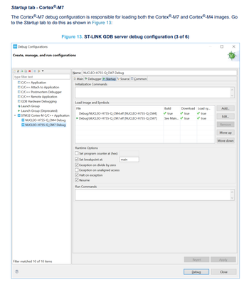

Hello @SSala.3 ,
Make sur to create and configure properly the "Debug Configurations" for both cores and check your setting of 'halt' option.
For that, I invite you to follow the steps in the AN5361, in "3. Debugging section", this will help you configure your project in the STM32CubeIDE.
