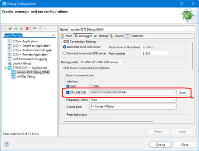

@FranzCreva wrote:with the STM32 compiler I received a new one "No ST-LINK with the specified serial number detected!
That's not the compiler - that's the debugger.
Sounds like you've set your Debug Configuration to require a specific ST-Link with a particular serial number:
That means that it will refuse to connect using any other ST-Link.
If that's not the behaviour you want, then uncheck the 'ST-LINK S/N' box.
Addendum:
If you do want to keep it so that it will only ever connect to one specific ST-Link, but want to use a different ST-Link (ie, different serial number), then use the 'Scan' button and select the serial number of the ST-Link you wish to use.

You're totally right @Andrew Neil, I was hoping that the error that the STM32 Cube IDE was giving me was consistent with the errors that the other programs were giving me.
I unchecked the 'ST-LINK Y/N' item and the ST-LINk was seen.
