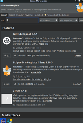

just tried, at first, same behavior on IDE 1.17.0 , but then see market; so needs long time, to show anything.
ed
tried again , on 1.18.1...seems ok:
