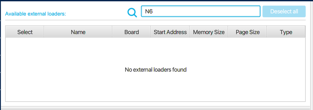

I am also unable to find any loader scripts for N6 in the Programmer GUI:

Hello @jmole
My suggestion for you is to upgrade to the latest STM32CubeProgrammer release (v2.20). STM32N6 has been introduced pretty recently and I doubt v2.13 has any support for it.
Aziz
