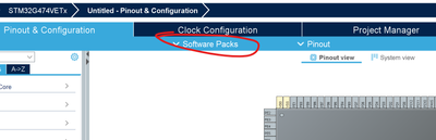

2025-05-07 5:56 AM - edited 2025-05-07 5:56 AM
It can be found within the "Software Packs" tab.

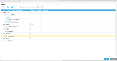

2025-05-07 5:59 AM
I have only this...
And I can't open Manage software packs.
