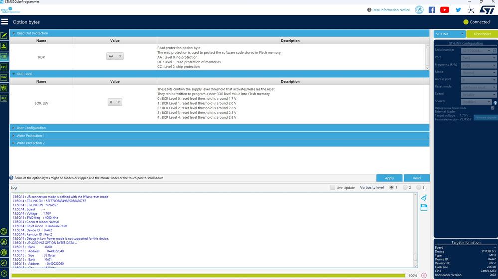

2024-08-06 3:07 AM
I checked and there is currently no enabled protection on the chip.
I can read and write the chip memory with the STM32CubeProgrammer and I even erased the chip but still the same problem.
