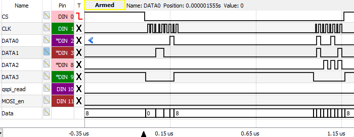

}As result, I see by Logic Analyser the next picture:
The first burst of clocks corresponds to the transmission if Command, the 2nd - to the Data. The gap between two bursts is about 0.76 mks in the case of using of HAL_QSPI_Transmit_IT and 1.5 mks in case of HAL_QSPI_Transmit which is somehow strange.
But the main question how I have to organize QSPI transmission without delay between Command and Data?

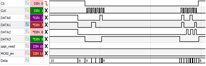

Ok, I have to repeat test. Here is results:
Code:
// configPRINTF( ("qspi: Command to Address = 0x%08x\n", sCommand.Address) );
HAL_StatusTypeDef result = HAL_QSPI_Command(&hqspi, &sCommand, QSPI_TIMEOUT_VALUE);
// if ( result != HAL_OK ) {
// qspi_error_handler(result);
// return result;
// configPRINTF( ("qspi: Transmit NbData = %d\n", (uint16_t) *tx_length) );
// result = HAL_QSPI_Transmit(&hqspi, TXbuf, QSPI_TIMEOUT_VALUE);
result = HAL_QSPI_Transmit_IT(&hqspi, TXbuf);
// return result;
return HAL_QSPI_ERROR_NONE;Logic Analyser:
