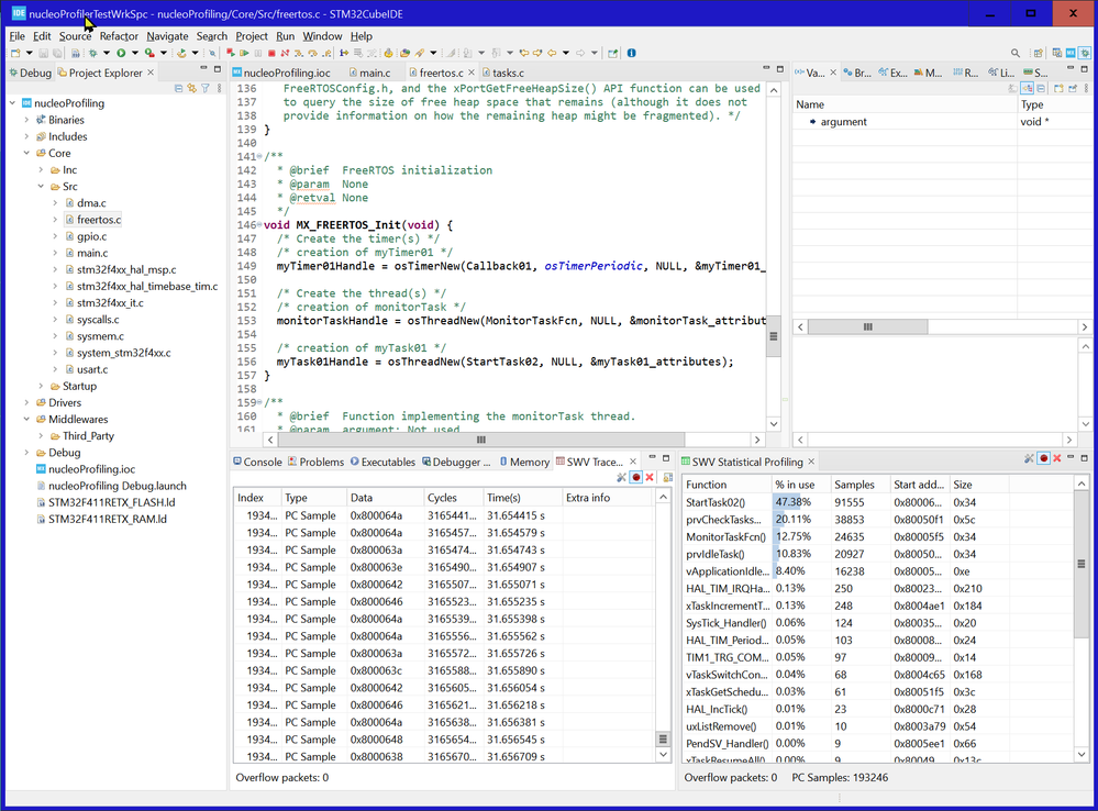

I thought maybe it was my CubeIDE Install, so I tried profiling on a Nucleo F411RE. It worked fine:

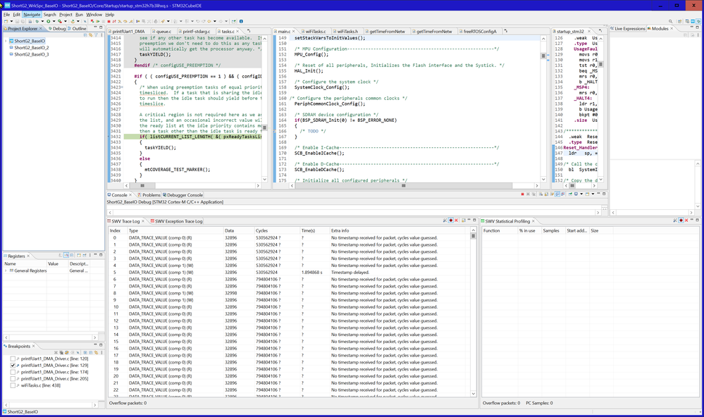

The STM32H73BIL gave:
From the trace log of the STM32H73BIL-DK it would appear that instead of sampling the program counter, the trace system is sampling at least two of the address comparitors although none of the address comparitors is enabled. The Nucleo on the other hand is sampling the program counter.

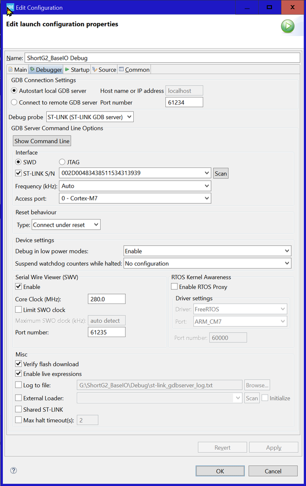

Debug -
The Trace Settings:

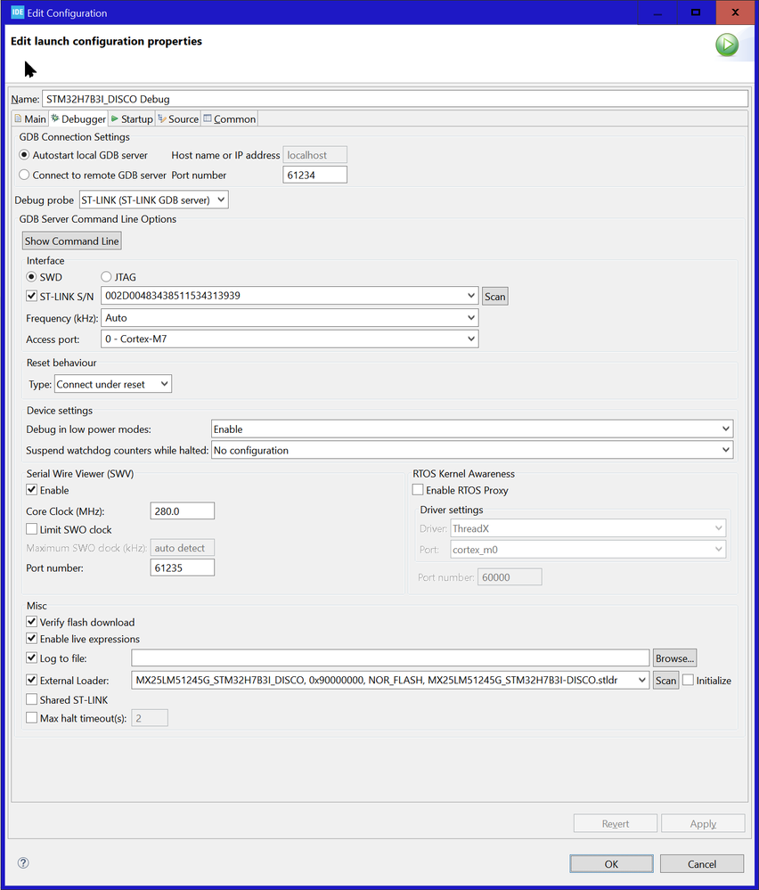

Perhaps a bit late on the ball, but had a similar request which linked to this forum post...
Did you solve this one?
I can re-produce the behavior of trying to get PC samples but packets coming over SWO pin interpreted as DATA_TRACE packets.
In my case this happens if I set an incorrect Core clock in the debug configuration. It I make sure it is aligned with the HCLK on target, then the H7B3I-DK works well for me with SWV profiling.
Could you check?

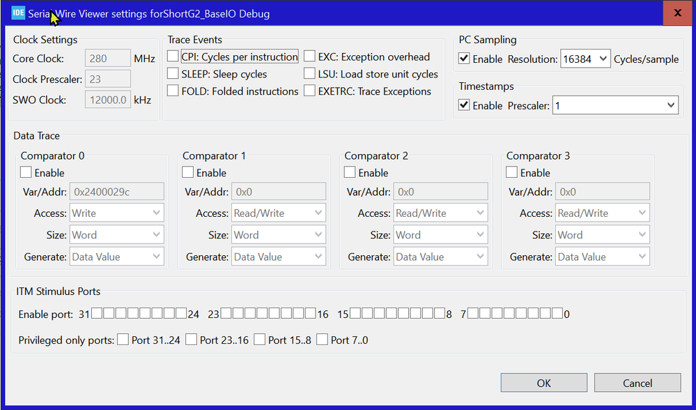

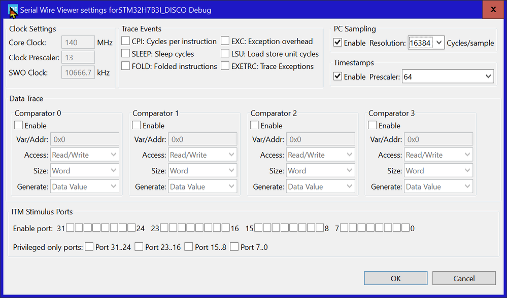

}Suspecting you are correct about the clock frequency setting being incorrect I set the Debuh clock setting to 140 MHz and it now seemt to be working.

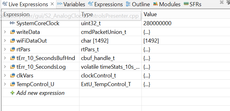

I am confused however as when I work my way through the CubeMX Clock tree I get 280, SystemCoreClock sys 280 and when I look at the clock initialization code that lines up with t CubeMX and also gives 280.
The problem I fin is that the nomenclature of the CubeMX clock tree does not line up with the clock code. i.e. SystemCoreClock is not shown on the CubeMZ tree and I am assuming its the signal that goes to the CPU Clocks (MHz).

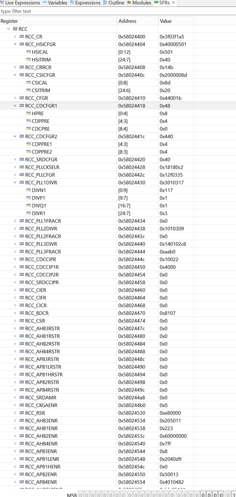

I took a screen shot of the registers:
SWV Settings:
I think I've figured out the terminology now, the CubeMX nomenclature refers to RCC register sub fields. But i still reckon the clock is 280 MHz not 140.
Any ideas on what I'm doing wrong. I'm worried now that the CPU clock is 140 not 180.
Best regards Rob

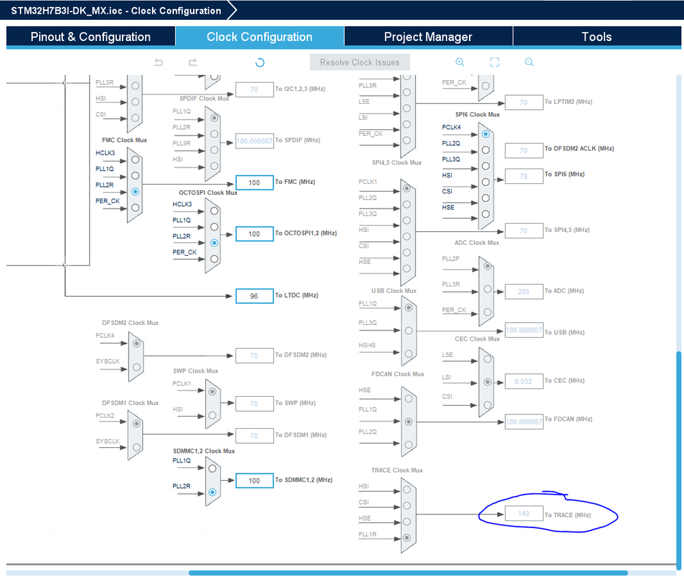

2022-10-17 6:32 AM
Hi again,
Resurrecting this thread since I learned from a colleague that the clock tree inside STM32H7 is different vs other MCUs. For H7, the SWO clock is sourced from a separate mux: "Trace Clock Mux".
This is a change in the clock tree of STM32H7 vs other STM32 products. In old products the trace clock was sourced from HCLK.
We should update the label in the GUI...
So, on H7 devices - please have a look at the MX clock tree at the bottom right side where you will see the "Trace Clock Mux" to know the value to be used.
Will see if I can dig up some more details...
