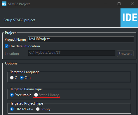

how does it work to create a static library for a dual core processor? While starting under CubeIDE with "New Project", the point "Static Library" is not usable, for instance, when use the STM32H745 (M4 & M7 Core). Is an application note available, how to do it?
Thanks,
Jan

Hi @JPiet.3,
I recommend you to have a look to the User Manual UM2609 available on our Website and precisely Section 2.2.2 Creating a new STM32 static library project.
Maybe this post helped you.

2022-10-17 3:39 AM
Yes, thanks, it's working now. More difficult was to link the .a-File to my code because for the include path, you need the miscelaneous tab and not the libraries-tab to use the new object file.
