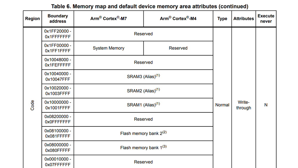

Hello @The_Interrupt_Vector ,
STM32H747XIHx MCU is a dual core product, and it has dual bank feature the ideal configuration is to assign each bank to a core as demonstrated in the example if you inspect the linker files for booth core you will see that each core is getting a bank assigned to it.

There are lots of ways to validly floor-plan the available resources.
When used as a dual-core, you need to decide which core uses/manages which memories. The M4 typically starts with the assumption that it's code lives in FLASH at 0x08100000
You'll need to think more broadly about where each core situates it's HEAP, STACK and STATICS. Watch how tightly coupled the different memories are situated to each of the cores.

You didn't mention where you find this linker? in CubeH7?
Meanwhile, CM4 and CM7 both access the entire 2MB but for program and literal pool, you can limit the boundary as you want with the related linker file. You can even disable one core in the option byte and make the another uses the all 2M of the flash memory.

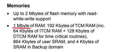

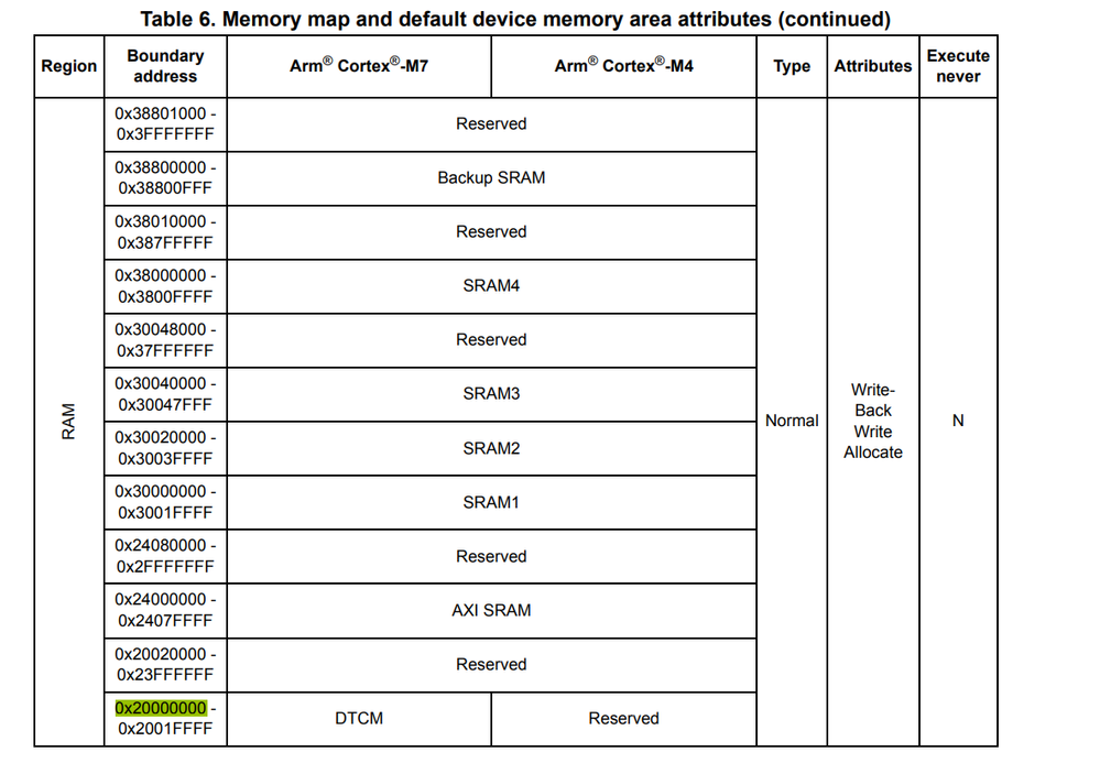

For the SRAM, I didn't understand your point:
@The_Interrupt_Vector wrote:
Additionally, I noticed that the total RAM defined in the linker file is divided as follows:
  • RAM_D1: 512 KB
  • DTCMRAM: 128 KB
  • RAM_D2: 288 KB
  • RAM_D3: 64 KB
  • ITCMRAM: 64 KB
The sum of these gives a total RAM size of 1056 KB, not the 1 MB typically mentioned in documentation. Could anyone confirm if this breakdown is correct or if I’m missing something?
These SRAM sizes are correct. It's true that in the datasheet it says 1M of SRAM but indeed it's 1056kB excluding Backup SRAM. May be the wording could be "more than 1M of SRAM".
