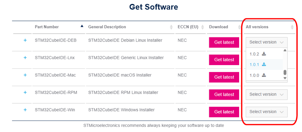

Note that it is possible to download old versions of CubeIDE - all the way back to 1.0.0
and CubeMX back to 6.2.0

Good to know that it's possible to get all versions ever released. Would have been my "plan B" if I was not able to get the project up and running. Fortunately, I got it up and running :) Informations below.
