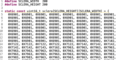

Hello Community,
I have several really large const arrays (with graphics data for LCD displays) which need not to be copied into RAM at startup, as this overflows my available RAM (on STM32F411 Discovery board). As there is no way to configure such behavior in STM32 Cube IDE I have tried to modify the linker scripts but GCC linker keeps ignoring my modifications.:face_with_rolling_eyes:
Does anybody have experienced the same problems or have some ideas how to convince the linker not to copy that sort of data into RAM? Data access speed is no issue as the speed bottleneck is in any case the display (connected via SPI).

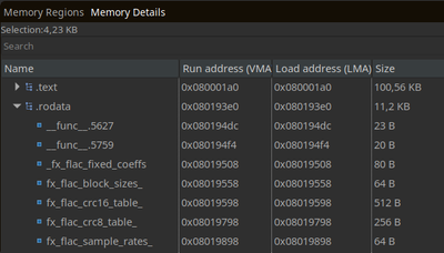

ie from prog on stm32f103 : graphics font for tft
and in mem:

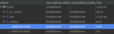

ok, so for F411 board:
and (with unmodified settings)
const var -> in flash. only.
(here a flac+ mp3 decoder running, tables never would fit in his small ram)

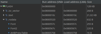

++ found F407 prog now:
gives

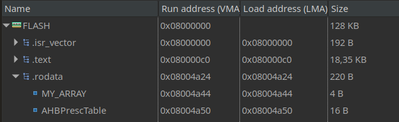

last idea:  try to give the place...  (not sure, that i write it correct)
__attribute__((section(".rodata"))) const uint8_t MY_ARRAY[] = { 1, 2, 3, 4 };
makes
