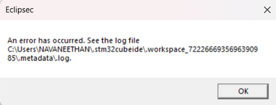

2025-01-31 2:29 AM
I'm also having this issue, in my scenario i create a project in STM32CubeMX_6.13.0 and generate the project after this i added a paths in paths and symbols and again i edit the IOC in STM32CubeMX and try to Re-generate the project but it shows ERROR POPUP like thisERROR POPUP
after this i try build but it didn't build errors are came like this total 40 error all are Hal and oskernal error
D:/NAVANEETHAN/CoffeeMaker/DisplayControl/Project/DisplayControl/CM7/Core/Src/main.c:116: undefined reference to `HAL_Init'
any one help me for this issue
Thank you
