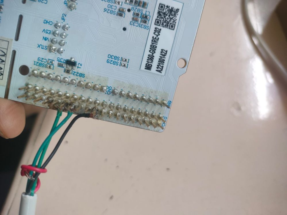

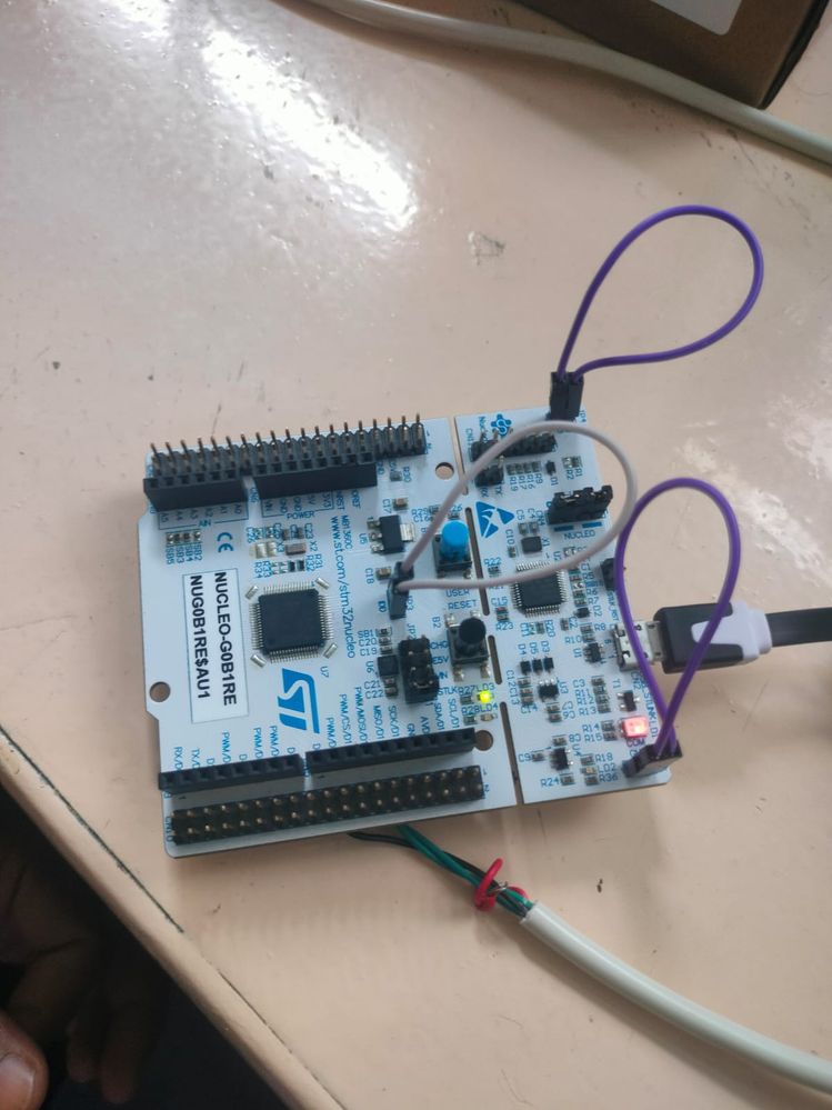

2024-07-12 12:33 AM
Can you show i pic of the build - esp. the usb connection ?
2024-07-12 2:02 AM
2024-07-12 2:42 AM
Might work. :)
Sure about (2x green wire) DP+/- ? If puzzeled, it never works.
In Cube , setup: have you usb- PD enabled ? Disable, if you did.
