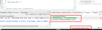

I am having an issue which is persistent for more than a week. I created a simple blink LED program using STM32 CUBE IDE IDE. I compiled it OK. Then, I tried to run it on the board, CUDE IDE got stuck. I can see from the progress bar that Launching: initializing debugger services. The progress is stuck at %51 and does not change even if I wait for ages. To identify the root cause, I tried below steps.
So, it got me thinking that STM CUBE IDE on my PC has something wrong. As I can not purchase another laptop as a solution, I am looking forward to hearing some help from the community. Please see attachments and provide me some guidance.
Thank you in advance.

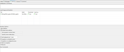

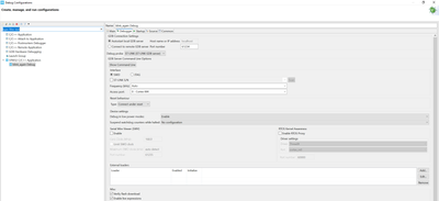

For more investigations, I suggest that you provide please the Debug session configurations and the Project.build.log File. You can find it under Properties (Alt+Enter)> C/C++ Build>Logging.
Thanks.
Mahmoud.
2023-12-21 2:19 AM
Hi Mahmoud,
Please find it below.

Seems your build config is ok , but debuger setup completely fail. create new debug configuration in debug button menu.

2023-12-24 7:20 AM - edited 2023-12-24 7:49 AM
I havent played with configuration, it is all default. Could you pls direct me what to check ?
