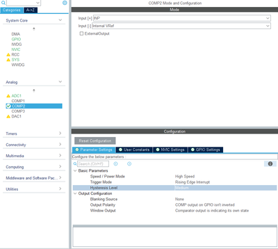

I have trouble setting up comparator on board nucleo-stm32G0b1RE. I've been following some tutorials on how to setup through stm32CubeMx, I believe I have the settings right, but I can't make the comparator work, it doesn't trigger the interrupt when I switch the input. Here is what I have so far:
in .ioc file

I don't use Cube/HAL, but you don't appear to have the COMP interrupt enabled anywhere, both at the peripheral level (and note, that COMPs are different from many other peripherals in that their interrupts go through EXTI, so you have to enable it there)  and in NVIC.
Maybe there are clicking setups for these in CubeMX too.
