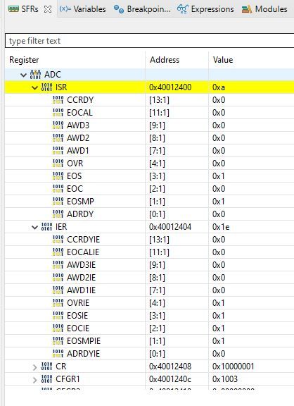

Do you understand why we think the DMA issue could be related ? At this point we know there are two issues but would not have seen the incorrect values till possibly later when verifying each individual PB pin value. If you are a moderator and would rather have two separate threads we can do that. This problem is currently being worked on and we don't want to go back to the previous polled ADC build because pin locations have changed on the hardware so it would required a half day of pin reconfiguration. Fixing the DMA issue first would seem to be the more timely avenue.
2022-07-27 11:47 AM
Wrong indexes are caused by ADC overrun happening because of interference by the debugger. When that happens, the correct action is:
2022-07-27 1:07 PM
I thought this might be the answer but I don't see any overrun isr's flags being set. Just End of Sequence and End of Sample flags.
2022-07-27 2:23 PM
Debugger may be intrusive simply by reading the registers. I don't know the minutiae of 'G0 ADC and maybe it's not a problem here; but not reading them by debugger while it's running means to stay on the safe side.
DMA is set as circular or you restart it in some way? And how exactly is ADC clocked and triggered?
