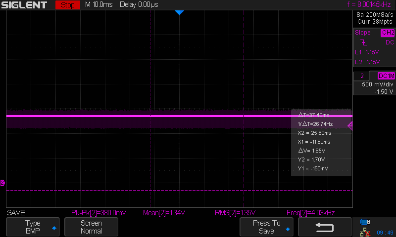

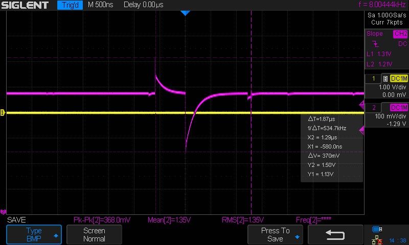

Took a scope reading and there is a small amount of noise but the high/low readings don't fall into what the scope is showing. Scope is showing a 1.35volt mean and my 1msec samples min/max readings are 1775/1786 which equates to 1.43065/1.439516.

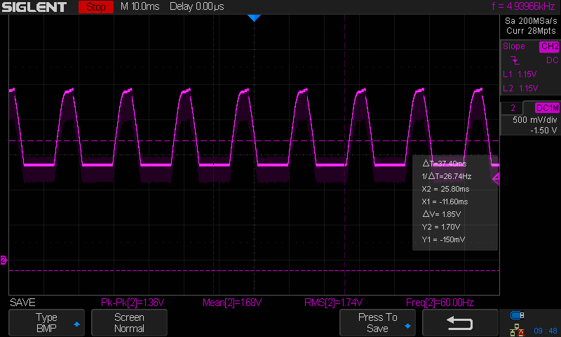

We do a ADC calibration that the Cube generated code performs after the ADC and DMA channel are set up. We have tried shorter and longer sample periods but it has minimal effect. We have some type of setup issue with the ADC to DMA. Each of the ADC pins can have one of four signals present based a two dip switch settings. With both switches off(0-0) you get this:
Switch setting 1-0 you get this:

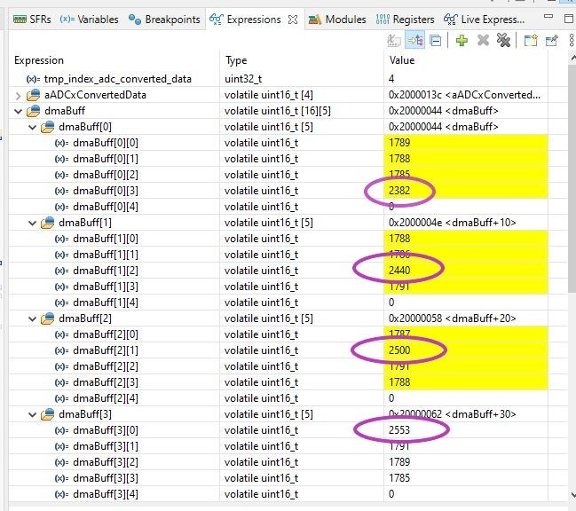

By finding the min and max on a particular pin, you can derive the dip switch settings. Late yesterday I noticed that when I changed the dip switch settings on PB0, every DMA buffer was being changed. Here is a debug capture of the DMA buffers where you can see the PB0 value walking across different indexes when it should be staying in the same DMA one. We must have something incorrect in the setup:
