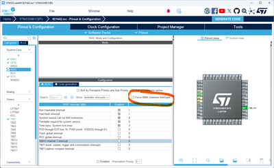

However, Cube MX automatically enables the DMA interrupt for TIM1_CH1 capture, and I don't want that.
My Question:
How can I disable the DMA interrupt for TIM1_CH1 in Cube MX, while still using DMA to store CCR1 values?
I want a clean solution that does not require manually disabling NVIC settings after every Cube MX code generation.

2025-07-11 10:48 AM
uncheck Force DMA channel interrupts, then you can disable the DMA interrupts in the table
hth
KnarfB
