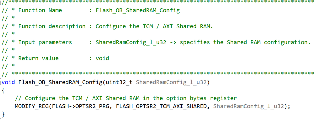

I got this issue when i am executing FLASH TEST, inside that i am calling OPTIONAL BYTE CONFIG

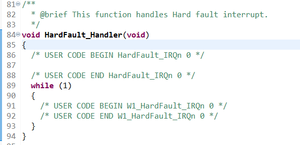

0693W00000QM3wzQAD.pngwhen i am calling it in main.c it is working fine but when i am trying to debug second time it is enter into HardFault_handler(void) function. when i am trying to reset or restarting it is not resolved it is throwing same fault
NOTE:- Now it is not working for all others modules. 0693W00000QM3yHQAT.pngplease help me with this issue,thank you in Advance

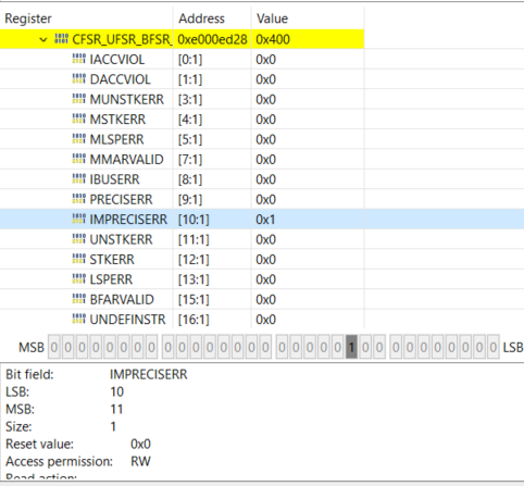

when i am observing SCB->CFSR register one flag(IMPRECISERR) is set with "1" ,AND one more register which is SCB->HFSR inside that FORCED set with "1".

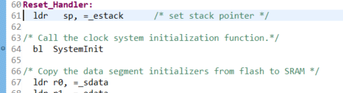

0693W00000QM4ADQA1.pngAfter line number 64 it is enter into Hardfault_Handle() state.

So your code is not reaching main function.

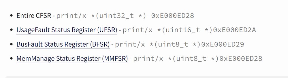

Use the below registers to know which error you are facing. And try to see from there.
Mostly UFSR or CFSR. But use a debugger and find the fault. 0693W00000QM4EyQAL.png
Imprecise suggests a WRITE

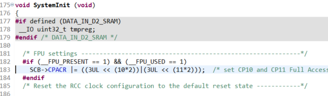

0693W00000QM84EQAT.pngAfter 183 line it is entering into Hardfault _handler. even i am not sure what exactly issue is.

when i am doing flash optional byte shared RAM configuration testing. when i am debugging it is working fine for first time when i am stopped and started second time debugging i am facing this issue, before entering into main() function it is hitting with Hardfault_handler(), aftter that i am trying with other modules it is hitting same thing , So i am not sure where the issue and what is the solution for that.
