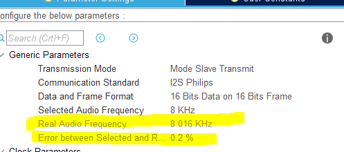

What I'm asking for is in the IDE to show the UART Baud rate error, like the I2S device does as below.

Agree with the suggestion to show nominal error.

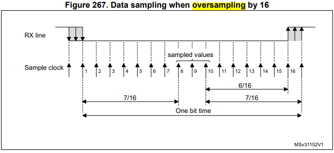

from RM0454 Rev 3 Page771
The oversampling method can be selected by programming the OVER8 bit in the USART_CR1 register either to 16 or 8 times the baud rate clock (see Figure 267 and Figure 268).
Depending on your application:
• select oversampling by 8 (OVER8 = 1) to achieve higher speed (up to usart_ker_ck_pres/8). In this case the maximum receiver tolerance to clock deviation is reduced (refer to Section 26.5.8: Tolerance of the USART receiver to clock deviation on page 775)
• select oversampling by 16 (OVER8 = 0) to increase the tolerance of the receiver to clock deviations. In this case, the maximum speed is limited to maximum usart_ker_ck_pres/16 (where usart_ker_ck_pres is the USART input clock divided by a prescaler).
--end of quoting--
Thus @64MHz using 16x oversampling the maximum baud rate is 4MHz.
So 'ideally' if 16x oversampling, SYSCLK should be a 16x multiple of the baud rate.
or 'ideally' if 8x oversampling, SYSCLK should be a 8x multiple of the baud rate.
