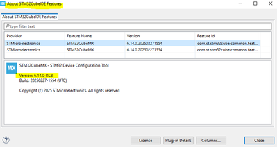

2025-03-05 5:12 AM
Hello @Mahmoud Ben Romdhane
If i update the hole STM32CubeIDE, the newer version of the STM32CubeMX is not included?
Best regards
2025-03-05 5:21 AM
Hello @AnthonyRFC ,
STM32CubeIDE 1.18 contains the last integrated version of STM32CubeMX : 6.14.0-RC8.
Thanks.
Mahmoud

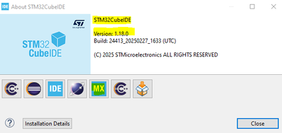

2025-03-10 4:58 AM
I update the STM32CubeIDE to the version 1.18 and the issues gone.
Thanks so much!
