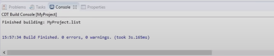

I would say you can find interesting informations in the log section of the cubeIDE (console).
See below an example where the needed time for the project build took around 3 seconds
As modifying your code you can see each time the needed time in the console and compare the results.

2020-07-29 8:28 AM
Run time, not compile time..
