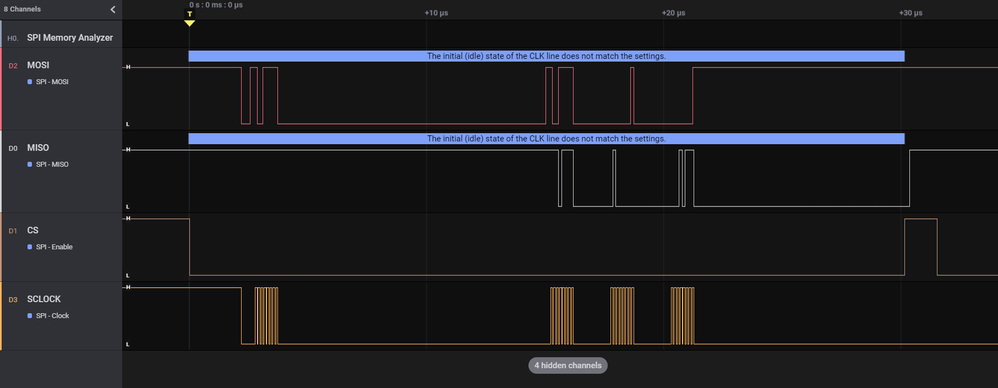

I have a problem that seems to common in the SPI field, specifically the idle state of the SCK pin. My application needs a clock low idle state and after the turn on, it goes to high, corrupting the communication with an external SPI flash memory. I'm using STM32 CubeIDE 1.18.0

And screenshoot of the logic analizer in the first byte sended.

To keep SCLK low during bootup, use a pull down. The pull down only gets into effect when the uC has booted, but it should be activated anyways.

For deadline propuses, I just activated the pulldown resistor and it works! But that is the best way to accomplish it?
